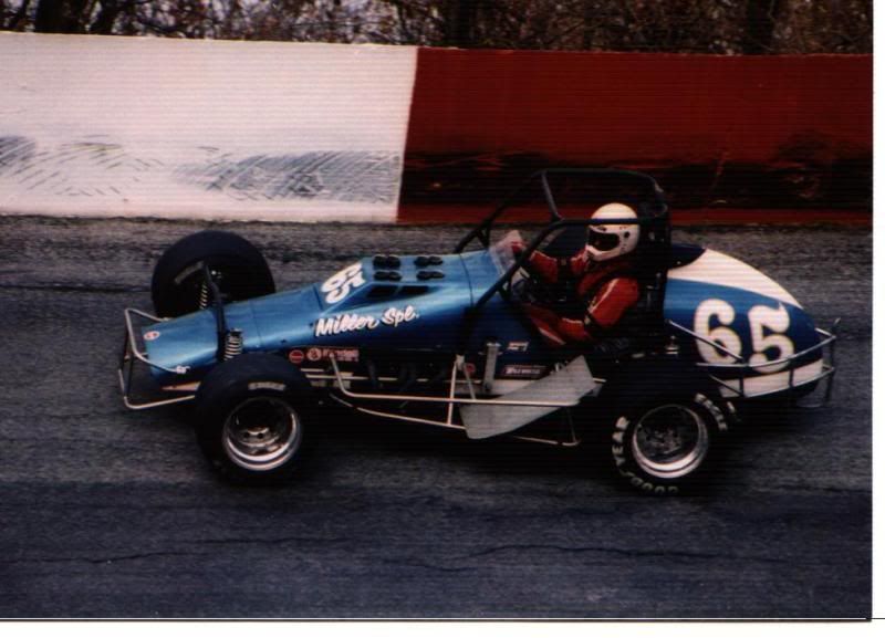

Funny Rich Vogler was never dominated by Chassey in the roadster. To watch Vogler beat him in an old upright was a thing of beauty. To watch Vogler drive the Miller plating car at Winchester beat BOTH supers and roadsters was a vision I will never forget.
I guess it just was a matter of who the driver is,and nobody was tougher than Rich.

Yeaaaaah....that was a good day. :thumb

I was there, King Of The Hill...Nobody then or now could out ball Richie V!
