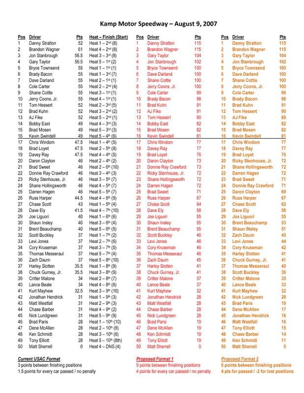

Kirk,
Here's the same Kamp race with a side-by-side comparison of 3 different passing point systems.
The first columns (black) is the actual USAC system that was used. It is a difference of 3 points between finishing positions with an added 1.5 points for each position gained. No points have been subtracted for drivers that finished worse than they started. This also shows which heat they were in, where they finished and where they started.
The second set of columns (red) is a passing point system based on your suggestion of 9 points between finishing positions with an added 4 points for each position gained. No points have been subtracted for drivers that finished worse than they started.
The third set of columns (brown) is a passing point system based on your suggestion of 9 points between finishing positions with an added 4 points for each position gained. 2 points have been subtracted for each position that a driver lost from where they originally started.
This is the only race from last year that I have the starting lineups on. To get a good feel of how a different system would work I still think you need to do a comparison of the last 2 years. That would give you 10 or more races to look at before you come to a conclusion.
